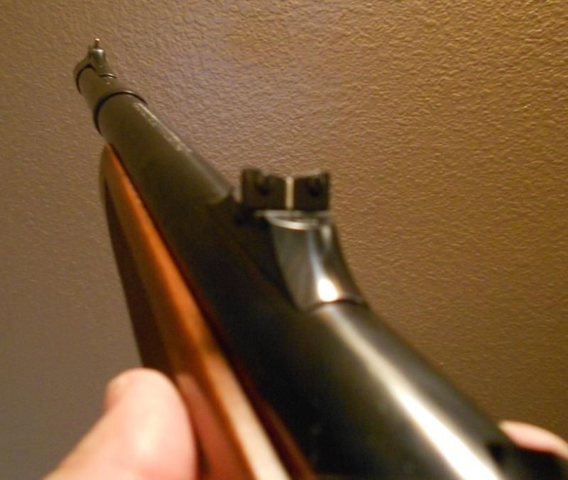

Well, after a great deal of praying for Ruger to come out with a short heavy barrel woodswalking 45-70 #1 carbine, I got impatient and had my own made... and it turned out great! I started with a Red recoil pad .458 Win Mag that was in mint condition. Then had the barrel chopped to 18.5" with NECG Masterpiece banded front sight with interchangable blades ( lots of options... Red high viz, gold & silver beads, night sights, a gold partridge blades of various heights). The smith said it was the largest dia. banded sight NECG offered. NECG Masterpiece adjustable rear sight cut to a British V shape with a white line added to complete the express sight set-up. Recrowned & blued the barrel, and contoured the original sight rib, so it looks part of the rifle, but there is just enough to mount a micro red dot. Last was upgrading the recoil pad to a Kick_EZZ Magnum which really take the bite out of this rifle! So far I have shot 458 Win Mag Factory 500 gr's, and some handloads using 350 gr. Hornady round nose at 2100 fps (these were easy to shoot and should handle everything I want to hunt). I also have some CPB bullets & Trail Boss powder that should make for some easy plinking loads. All in all, I couldn't be happier. I still don't see why Ruger won't make this gun? Its shorter than my Marlin Guide Gun, and points as natural as a Red Lable, and looks tuff as nails!
I don't have a way to post pics, but if someone was willing to post them for me I could send some their way.

Here's 240gr&up's short cannon....
Looks like a Thumper that's for sure!!! I'll post more pics after some better weather comes along!

Stump,
Thanks for posting my pics. I need to take some outdoor pics in better lighting. That a Marlin Guide Gun with an 18" barrel for compairison.

Which NECG front did you go with? (There are numerous)
With the new sight and shorter barrel- were you pretty close to point of aim?
 Profile
PostPosted: Thu Aug 16, 2012 5:27 pm
Offline
Joined: Thu Jan 28, 2010 7:33 pm
Posts: 76
Shooter,
The front sight currently has the smallest bead at the shortest height,
maybe .276??? and it's dead-on at 50 yards with 350 gr RN @ 2100 fps. When I use cast/ trailboss loads I will switch to a larger dia. Hi Viz a little taller. Also note, Im using a NECG adjustable rear sight, not the stock ruger.

Would the stock ruger rear work with that front
 Profile
PostPosted: Fri Aug 17, 2012 6:30 am
Offline
Posts: 76
I doubt it. The NECG rear sight is much lower.
